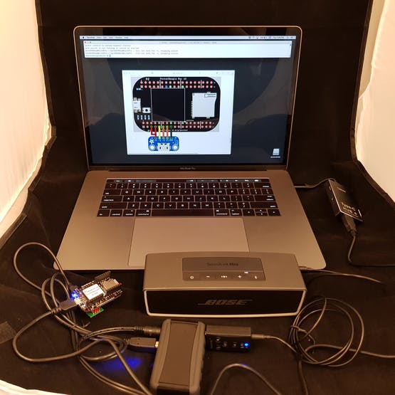

Connecting the USB Type A Female Receptacle Breakout Board to PocketBeagle
Power up PocketBeagle and connect to it using SSH. Then connect the USB hub and Sound Card. Check if the Sound Card is detected using the command
lsusb (lists all usb devices) or aplay -l (lists all sound cards) on terminal
Power up your PocketBeagle to check your connections

Text to Speech Using other OSD335x based Development Boards
You can add text to speech in this manner using any OSD335x based development board. We also built the project using the Octavo Systems
OSD3358-SM-RED Reference, Evaluation, Development Board
. This board uses the same OSD3358-SM System-in-Package as PocketBeagle. The OSD3358-SM-RED has additional full development features included such as sensors, ethernet and USB on the board. The set up is shown below:
Text-to-Speech set up with OSD3358-SM-RED
