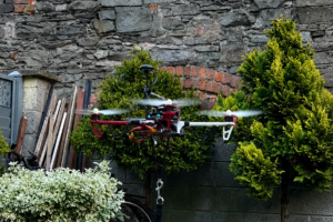

BeagleV-Fire Quadcopter first test flight.

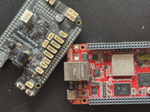

First board: BeagleV-Fire
BeagleV-Fire — PolarFire SoCs and the Robotics cape.
The first target is the BeagleV-Fire. It’s a Microchip PolarFire SoC board with five RISC-V cores (four U54 application harts plus one E51 monitor hart), roughly 250k elements of FPGA fabric, and BeagleBone-compatible cape headers.
For a flight controller this is an unusual mix. The CPU runs the flight code. The fabric generates servo PWM directly, so output jitter is set by silicon rather than an OS scheduler. Sensors — MPU-9250 IMU, BMP280 baro, AK8963 magnetometer — hang off the PolarFire’s MSS I²C bus.
Zephyr sees all of this as ordinary DT nodes. The fabric PWM is a small out-of-tree driver in the HAL (drivers/pwm/pwm_fabric_servo.c) behind the compatible beaglev-fire,fabric-servo-pwm. It’s gated on that compatible appearing in the Devicetree, so it compiles away to nothing on any other board.

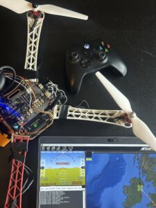

What runs today
Bench test: ArduCopter on Zephyr talking MAVLink to Mission Planner.
On a BeagleV-Fire running Zephyr on its own (single U54, no Linux):
  • ArduCopter boots and enters ardupilot_entry().
  • MAVLink telemetry at 115200 baud over MMUART2, talking to Mission Planner.
  • EKF3 state estimation (it’s hungry — 32 MB of heap).
  • IMU at 1 kHz, baro and mag at their usual rates.
  • Fabric-generated PWM on the servo outputs.
  • Parameter storage on a microSD card (FAT32 over SPI).
  • Dual-LED status via ArduPilot’s AP_Notify.
