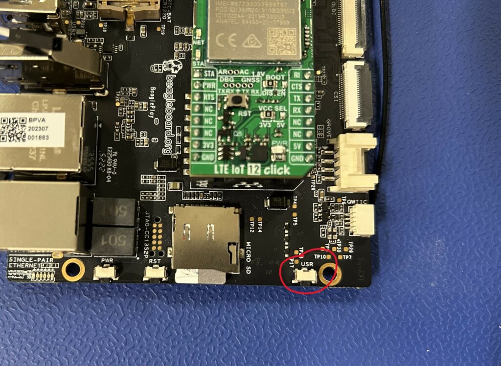

  5. Hold down USR button while applying power to boot from the microSD card

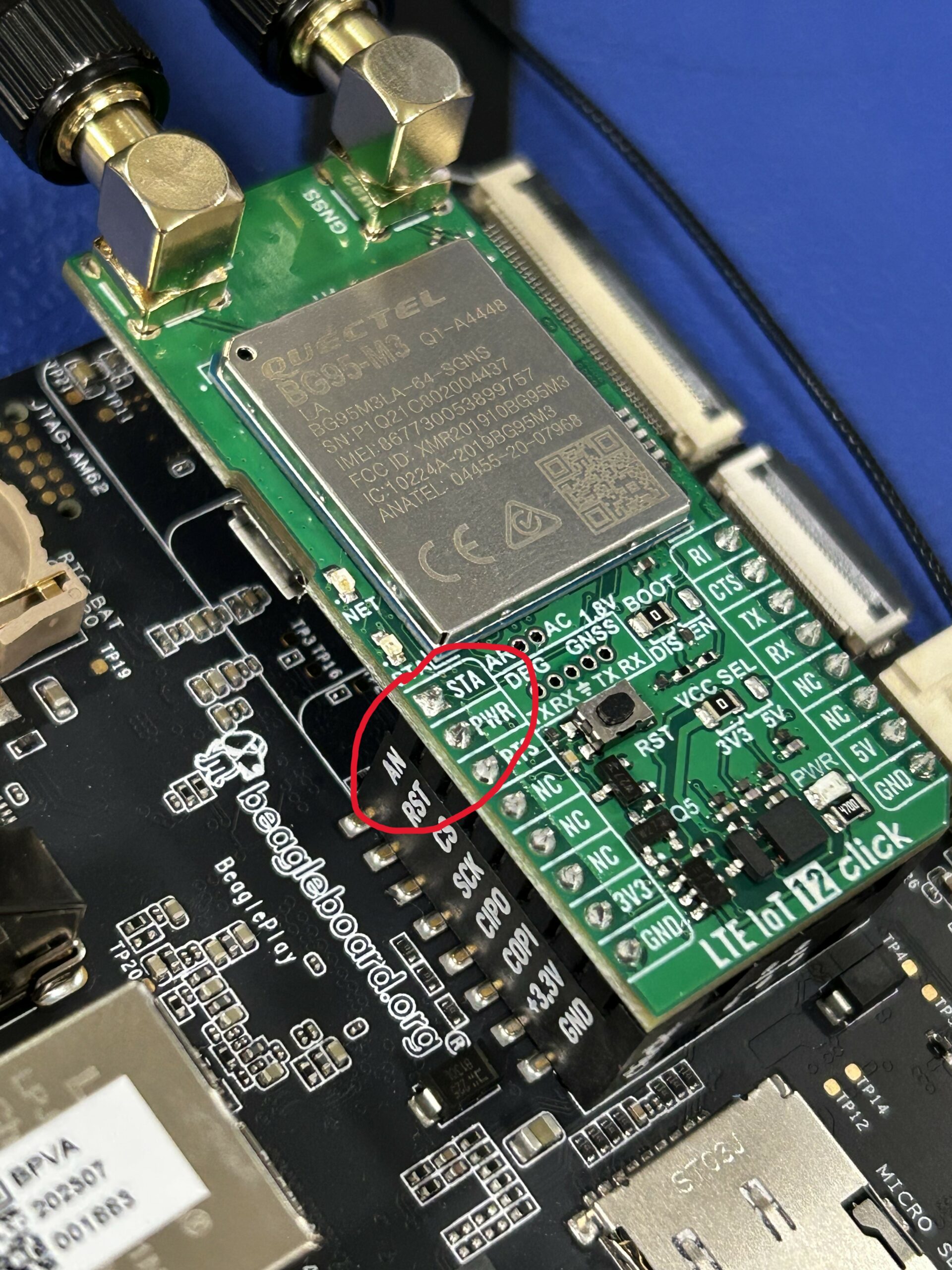

For kernel 6.12 the device tree source (DTS) file can be found here. The DTS file did not need modifications due to the utilization of the mikroBUS standard connector. Use the ctrl+F function and search “mikrobus” to look for the pins needed. The peripherals associated with the mikroBUS connector, such as SPI, UART, and I2C, are clearly shown but there is not much more information on GPIO pins. The next step is to identify which pins on the mikroBUS header connect to the relevant pins on to the modem.
The “STA” pin on the BG95 is connected to “AN” on the mikroBUS connector and the “PWR” pin on the BG95 is connected to “RST” on the mikroBUS connector for the BeaglePlay. The RST/PWR pin needs to be toggled first. To identify which GPIO this is, look at the schematic of the BeaglePlay.
The schematic shows that “AN” is GPIO1_10 and “RST” is GPIO1_12. This can be verified with the design files in the BeaglePlay design repository.

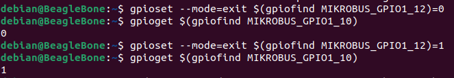

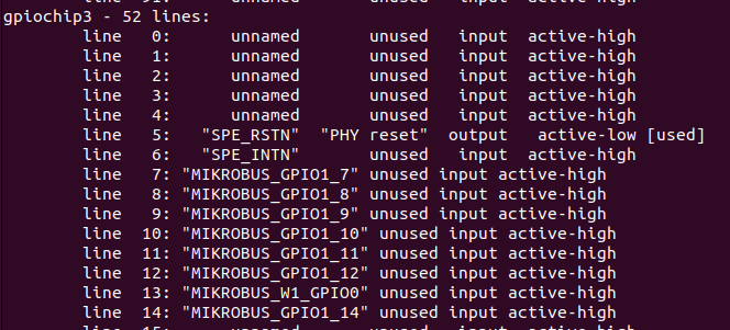

All of the GPIOs can be listed out with gpioinfo to see naming conventions.
gpioinfo
The above section is the relevant information from the output. The naming conventions of the desired mikroBUS GPIOs are MIKROBUS_GPIO1_10 and MIKROBUS_GPIO1_12. The commands for clearing, setting, and reading the pins of interest are below.
gpioset --mode=exit $(gpiofind MIKROBUS_GPIO1_12)=0
gpioget $(gpiofind MIKROBUS_GPIO1_10)
gpioset --mode=exit $(gpiofind MIKROBUS_GPIO1_12)=1
To turn on the modem first set the RST/PWR pin as an output and clear it to 0, read the AN/STA pin, it should read as 0 since the device is off. Then set the RST/PWR to 1, when reading the AN/STA pin, it should now read 1 since the device is on. This sequence is demonstrated below.

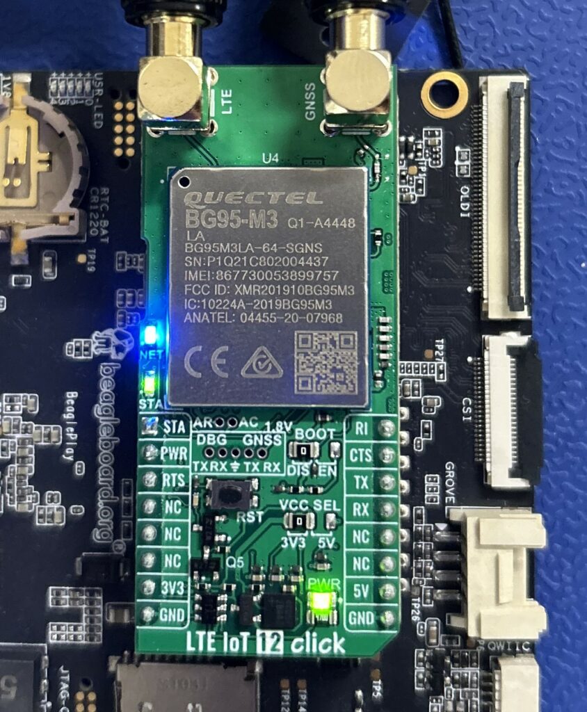

Wait a couple seconds and the blue and green LEDs on the BG95 should begin lighting up, indicating that it is on.

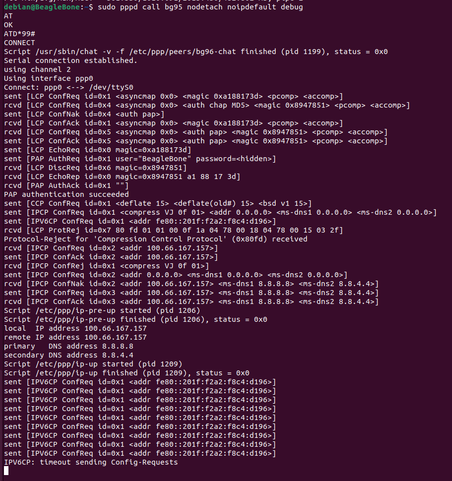

sudo pppd call bg95 noipdefault nodetach debug

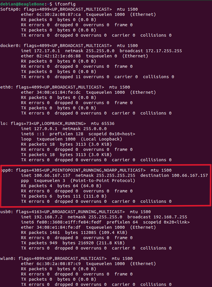

Let that connect. Now ifconfig can be used to see the ppp0 network interface.
ifconfig
The output shoes that the ppp0 network interface has obtained an IP address indicating successful network connectivity. Now test this connectivity by pinging Google’s IP address through the ppp0 port.

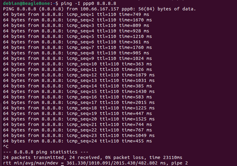

ping -I ppp0 8.8.8.8
With consecutive ICMP replies and 0% packet loss, the output demonstrates that the network link is active and healthy.
Congrats! A gateway connection through a cell modem has successfully been established utilizing Point-to-point protocol.
