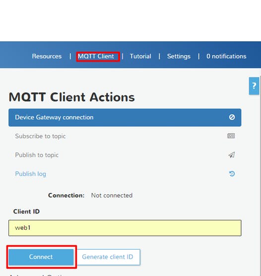

MQTT client
On your dashboard you have simple MQTT client :
MQTT client
Next step is subscribing and publishing to topics. From code you see that BeagleBone is going to send(publish) message to topic_2 and receive(subscribe) message from topic_1. According that, Subscribe MQTT client to topic_1 and Publish to topic_2
MQTT client with subscribe and publish topic
