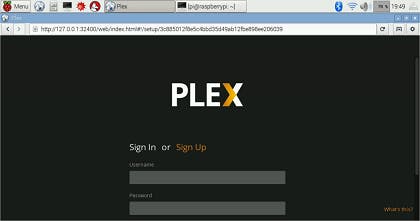

7. Open a browser window on your Raspberry Pi and go to http://127.0.0.1:32400/web
Once you’ve gone through the initial setup, you can access Plex Media Server as normal.
