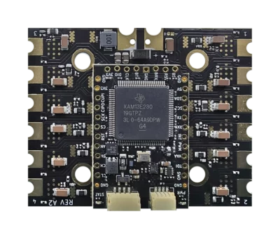

BeagleConnect Torque controller module, top view showing the microcontroller, CAN and Qwiic connectors, expansion pins, and debug connections.

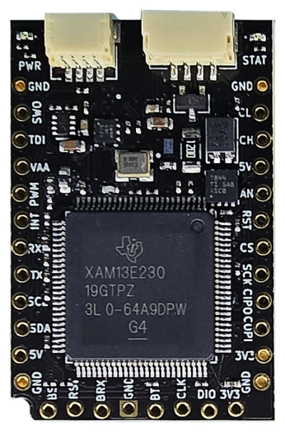

Bring real-time control, connected sensing and edge AI into your next design. BeagleConnect Torque is a compact, open-source controller module for developers, educators and embedded system designers building robots, motor controllers and CAN-connected devices. A Texas Instruments AM13E23019 microcontroller combines a 250 MHz Arm Cortex-M33 processor with dedicated math and neural-network acceleration, while onboard CAN hardware, Qwiic and expansion connections make it easy to connect your application.
At just 25.4 × 38.1 mm, BeagleConnect Torque brings the controller into your own hardware through a 100-pad solder-down interface. Use the same module to explore control algorithms, prototype a sensor or actuator node, and develop a custom carrier. Editable hardware designs, firmware sources and detailed connector references give you a starting point you can inspect, modify and build upon.
BeagleConnect Torque also provides the central controller for BeagleConnect QuadESC, coordinating four three-phase brushless DC motor channels. Pair BeagleConnect Torque with suitable external gate drivers, power transistors and application firmware to build your own motor-control system.

BeagleConnect Torque ships with TI’s ROM bootstrap loader. Load your application through CAN, I²C or UART using the TI bootloader protocol, or program and debug through Serial Wire Debug. The documentation includes TI XDS110 wiring and Code Composer Studio setup. Development targets community-aligned Zephyr and OpenOCD support; consult the current documentation for board and tool compatibility.

  • Connected control: Onboard TCAN844 CAN transceiver, four-pin JST-GH CAN/power connector and software-selectable 120 Ω bus termination
  • Sensor expansion: Qwiic connector for 3.3 V I²C accessories
  • Flexible I/O: Two 12-pin expansion rows with UART, SPI, analog, PWM and control signals; refer to the module pinout for multiplexing and accessory connections
  • Analog acquisition: 30 assigned analog input pads through the carrier interface, with a separate carrier-supplied analog reference
  • Programming and debug: Eight-pin connection for Serial Wire Debug, UART, reset, boot selection, ground and 3.3 V debug power
  • Power: Nominal regulated 5 V carrier input, onboard 3.3 V regulation and automatic selection between carrier-derived and separate 3.3 V debug power
  • Carrier integration: 100-pad underside land-grid array at 1.27 mm pitch
  • Compact PCB: 25.4 × 38.1 mm outline; four-layer, 1.6 mm PCB
