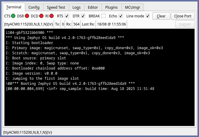

  1. Check serial output.
❯ tio /dev/ttyACM0
[11:52:04.720] tio 3.9
[11:52:04.720] Press ctrl-t q to quit
[11:52:04.720] Connected to /dev/ttyACM0
** Booting MCUboot v2.2.0-104-gbf5321bb6906 ***
*** Using Zephyr OS build v4.2.0-1763-gffb28eed1da9 ***
*** Booting Zephyr OS build v4.2.0-1763-gffb28eed1da9 ***
[00:00:00.004,699] <inf> smp_sample: build time: Aug 18 2025 11:51:48

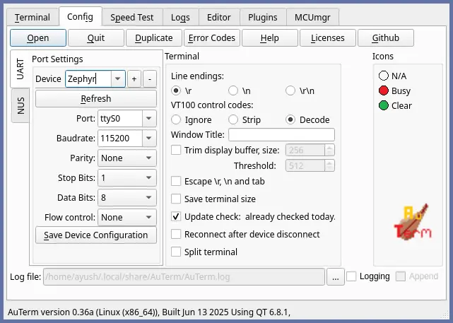

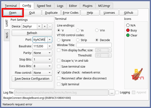

  1. Launch AuTerm.

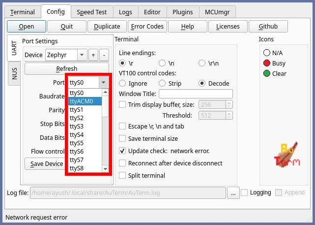

  2. Select BeagleConnect Freedom Port.

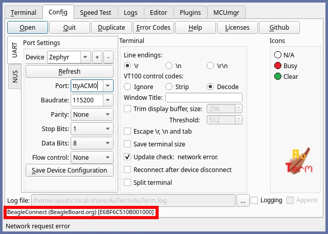

  3. Verify the port.
  4. Open the Port. This will drop you into the Terminal tab. Take note of the build time.
  5. Press the reset button on BeagleConnect Freedom and verify the serial output.

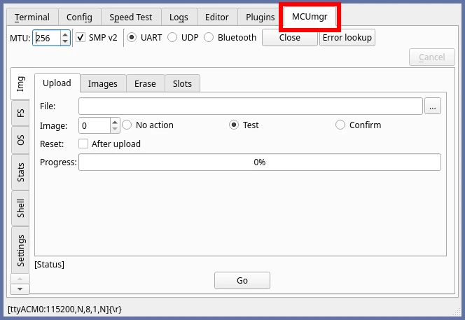

  7. Navigate to the MCUmgr tab.
  8. Select the newly built signed firmware.

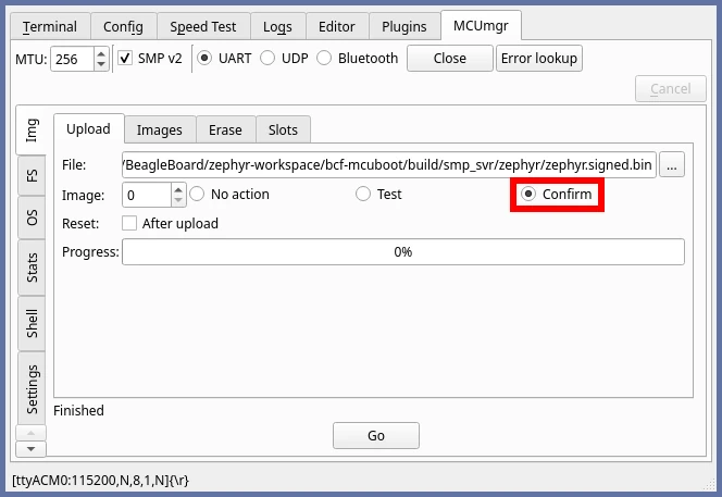

  9. Switch action from Test to Confirm.

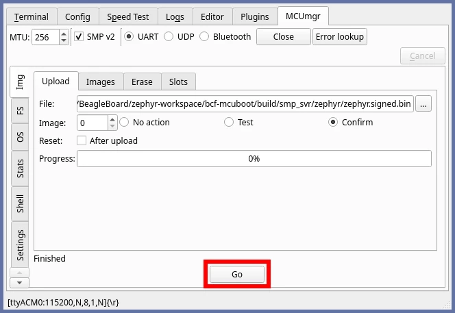

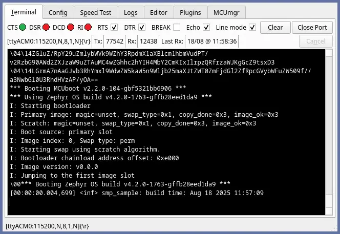

  10. Press the Go button to start firmware upload.

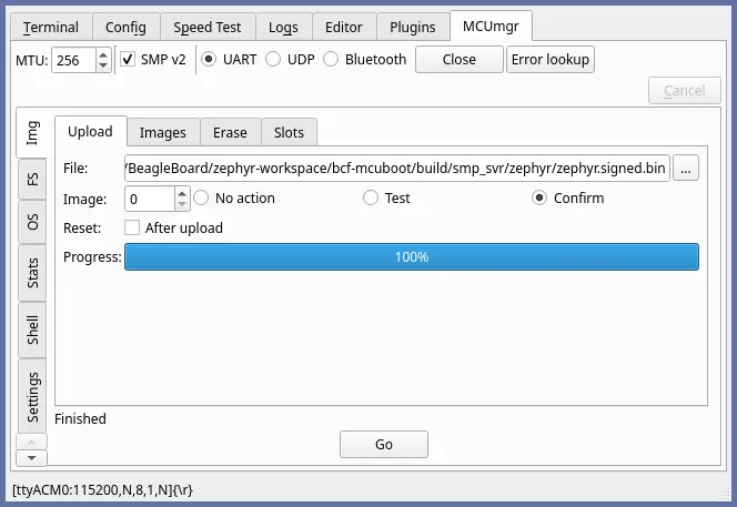

  11. Wait for the firmware upload to finish.
  12. Navigate to the Terminal tab to verify that the build time has changed.
